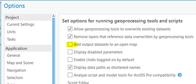

I started Pro and went to Settings>Options>Geoprocessing.

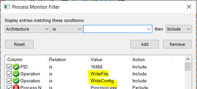

I downloaded, installed and started SysInternals ProcessMonitor.
I dragged the "Include Process from Window" icon and dropped it onto the Options window.
I added two Filters to process Monitor:
I unchecked the "add outputs to open map" option, and clicked save.

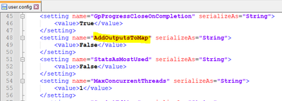

ProcessMonitor shows Pro is writing to :
C:\Users\kirkk\AppData\Roaming\Esri\ArcGISPro.exe_StrongName_yhpsrysqpn4fvmb0spwbakt5o5e50din\2.7.0.0\user.config
I open the file in notepad and see xml setting for AddOutputsToMap set to false.
