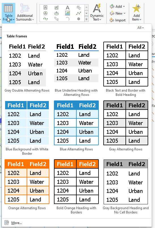

CharlesMacleod
Layout uses TableFrames. That's the closest equivalent. TableFrames, tho' are tied to layers I believe - not free-form text.
