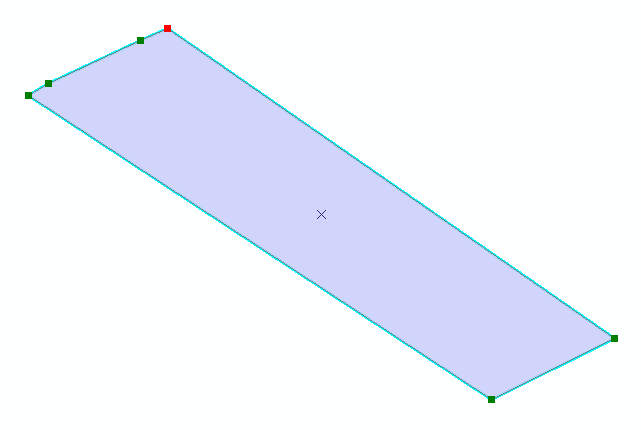

I noticed that GeometryEngine.SimplifyAsFeature method produces strange results sometimes. For this polygon:

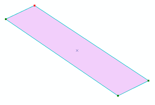

the method produces this result:
In my opinion such results are at least unobvious. Can you explain why I get it?

SimplifyAsFeature removes degenerate segments. A segment is degenerate if its length is less than 2 * sqrt(2) * tolerance of the spatial reference. The spatial reference for your data has tolerance = 2.0E-5, so any segment with length less than 5.657E-5 is degenerate. The length of the two shortest segments in the polygon are 3.3E-5 and 4.3E-5, so they are removed.
