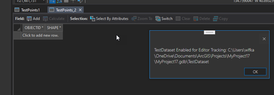

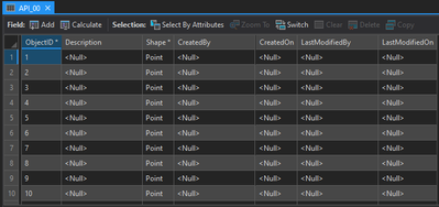

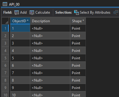

I used this snippet to turn this empty feature class
into this edit tracking enabled version:
Then i did the same for a feature dataset:
and this enabled all feature classes in my feature dataset:

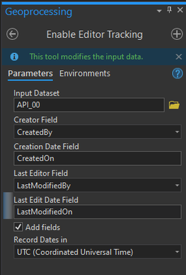

You have to use a GP tool to 'Enable Editor Tracking', you can call the tool from the API:

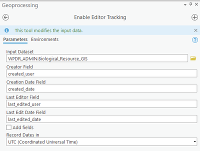

that tool only works on default fields or SDE created fields.  It does not allow user to select a field.  I need one which is similar to the tool located at feature class property window but can be applied to whole dataset which contains more than one layer.  of course the condition is that all the customized fields are same for the whole dataset.

I think I don't understand, the tool works for me:
then I get this result with the fields added:
I you want this to work on a whole dataset instead of just one feature class (or table) you have to iterate through all feature classes in that dataset and perform the action on each feature class.

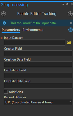

This is what i got by running this tool.  It did not give the option to select the field.  I am using AG Pro 2.7
