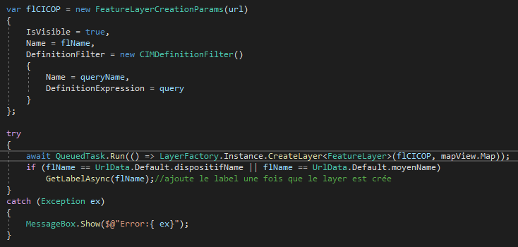

Right now, i'm adding my featureLayer to the map using that
The LayerFactory.Instance.CreateLayer<FeatureLayer>(flCICOP, mapView.Map) execute the query and add the featureLayer founded to the map. Now i need to rotate the symbol of each point on the map based on the attribute "sym_rotat"
