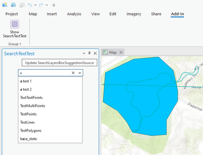

Using your XAML I made a 2.9 sample and then migrated the sample using the Pro Migration tool vsix: ProConcepts 3.0 Migration Guide · ArcGIS/arcgis-pro-sdk Wiki (github.com)
I attached my sample project for your reference.  The SuggestionSource property still exists, and my 3.0 add-in project compiled without error after the migration.   You can't find the SuggestionSource  property in the API reference guide because it is inherited from the ArcGIS.Desktop.Internal.Framework.Controls.SearchTextBox control and our online API reference guide always excluded such inherited "Internal" properties hence the property was not documented in the 2.x API reference guide.   Such properties can be used in add-ins but are not supported by the Pro API regarding the API's 'forwards compatible across minor releases of Pro' support.

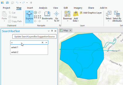

My sample code implements an initial Suggestion list:
and updates that list during runtime by clicking the button that adds feature layer names to the suggestion list.
