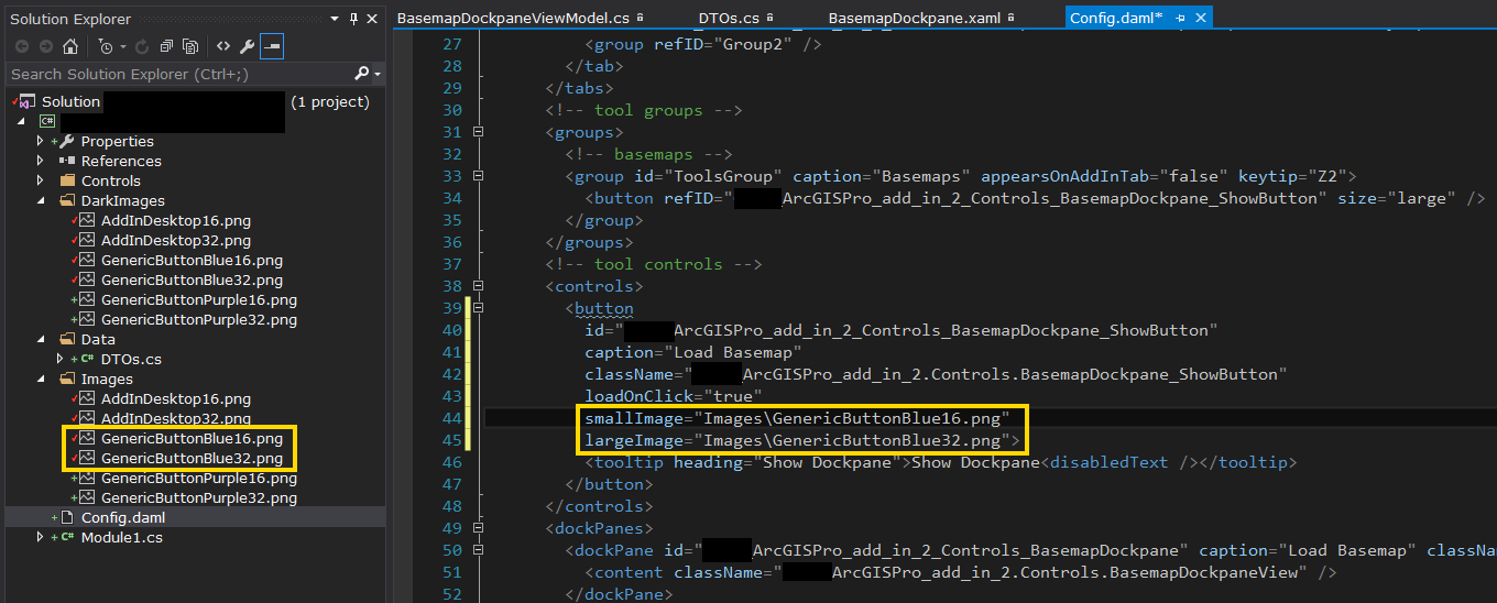

I can't seem to get the icon images to display in my ArcGIS Pro Add-ins.  I'm using the default sample icons provided in the ArcGIS Pro SDK Community Samples.  Here is a quick screenshot of my solution, showing the folders where the images are saved, and the Config.daml file where they are referenced:
However, the icons do not get displayed when the add-in is executed:
The icons DO work for the sample add-in projects, however.  The image files and location are the same in my solution and the sample solution. The markup referencing the images is the same as well.
What should I be looking for in my solution to properly set an image as the ribbon button icon in ArcGIS Pro?

CharlesMacleod
Make sure the build action is set to "AddInContent"

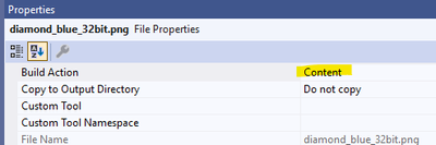

After some checking, it looks like the 'AddInContent' Build Action for icons (or png files) in Pro AddIn is now just 'Content'.
Of note, in your config.daml you have the 'stub path' to the icon in the Image tag like so: <Image>Images\diamond_blue_32bit.png</Image>
If your icon is still not showing, then add the .\images folder to your Add-In file structure and add the icons or pngs you want to display.

The solution was to use the image properties: "Content / do not copy".
I thought it had to be copied into the add-in anyway. However, ArcGIS Pro loads the images from the add-in, not from the build folder. The images are included directly from the project directory into the .esriAddInX package. When you select a copy option, Visual Studio also copies the image files to the bin\Debug folder. When building the add-in (.esriAddInX), naming conflicts or duplicate resource paths can occur. This can lead to the images not being included or referenced correctly, even though they are visible in the project.
