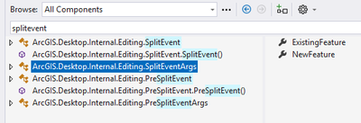

sjones_esriau
If you're brave you can try subscribing to the internal SplitEvent to get the new and existing feature.
Note this is an unsupported pattern.
