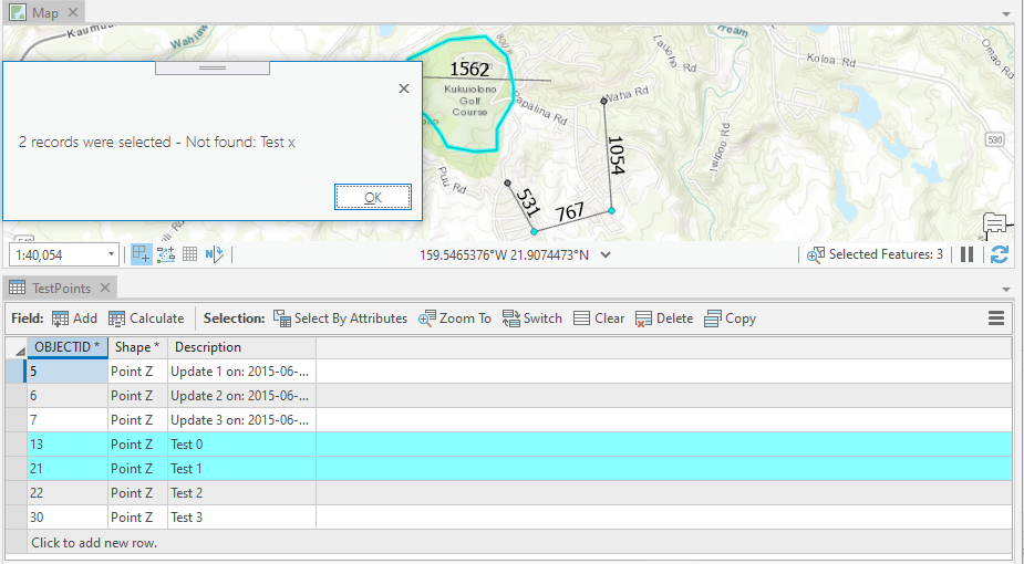

You can use the snippet below to get this result when searching for these accounts (type string) ' "Test 0", "Test 1", "Test x"' - Note that only Test x doesn't exist:
In essence you first do your selection and then search through the selected set one by one to find the 'missing' item.

helenchu
I've successfully got it worked with my codes.  Thank you so very much.  You're truly life saver!
