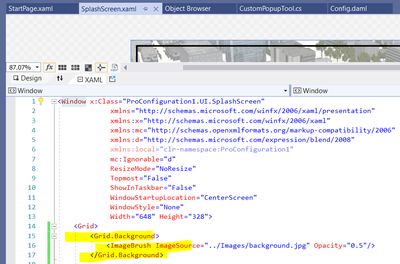

Thanks for the response back. I dont want the logo to be a background since I already have a desired background in place. I have attached a screenshot of my current product in the designer and snippet of the relevant code.

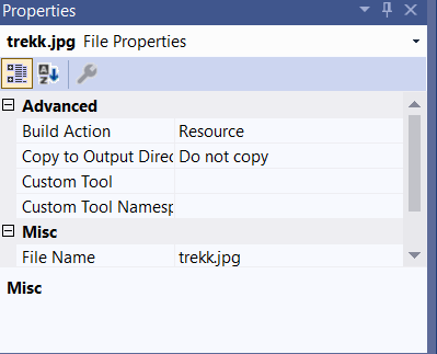

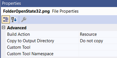

What are your build action, and copy to output settings set to?
JohnnyHarley232
Kirk, Attached is the setting for that photo. Is there any other setting I need to look at when building the solution?

KirkKuykendall1
The original question has
<Image Source="Images/trekk.jpg" />
But the follow-up post has

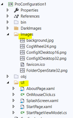

Esri's default when creating a splash via New>Project .... Pro Managed Configuration results in a project with a UI and Images folders.
Notice how the Source path in the xaml in the UI folder has a relative path to the images in the Images folder:
So, if your xaml is in a (UI) folder that is a sibling to the Images folder, perhaps try using a ".." for the relative path in the Source.
