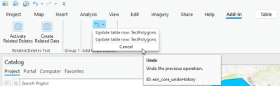

Try this:
<groups>
  <!-- comment this out if you have no controls on the Addin tab to avoid
        an empty group-->
  <group id="TestEditUndoButton_Group1" caption="Add Undo button" appearsOnAddInTab="true">
    <!-- host controls within groups -->
		<splitButton refID="esri_core_undoSplitButton" size="small"/>
  </group>
</groups>
You can find all undo associated daml ids here:  DAML ID Reference ADCore.daml · Esri/arcgis-pro-sdk Wiki (github.com)
