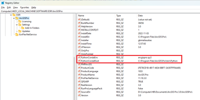

Hi,
You can read it from computer registry:
Code to read value:
RegistryKey registryKey = Registry.LocalMachine.OpenSubKey(@"SOFTWARE\ESRI\ArcGISPro");
object activeEnv = registryKey.GetValue("PythonCondaEnv");
object envPath = registryKey.GetValue("PythonCondaRoot");

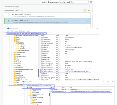

SurendraPinjala
Hi GintautasKmieliauskas,
Thank you for your message. Now I able to read the active ( cloned) environment from the Registry key HKEY_CURRENT_USER.
