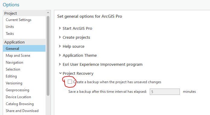

in ArcGIS pro sdk, is there a way to disable the option : "project recovery" (found in Settings > Options > Application > General > Project Recovery > "Create a backup when the project has unsaved changes").
We are doing a project where the save is managed otherwise, and would like to disable this option through a ProConfiguration/ProAddin as we also disable all the default menu to expose only our custom make menus. We could also do it during ArcGIS pro install as we do is silently using a .bat file and command line.
