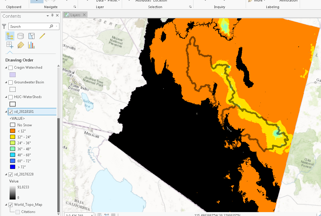

This image shows a non symbolized grid file added to Pro
non symbolized raster

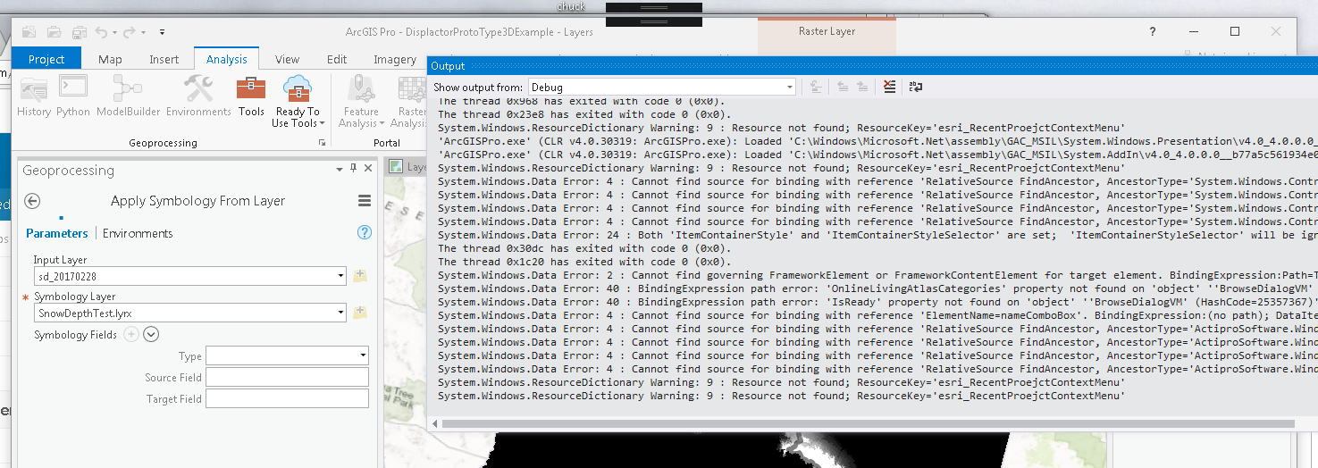

This image shows trying to run the tool using a .lyrx file as the symbology layer source.  This image also shows the output screen from Visual Studio that captures how it behaved after adding the .lyrx file to the Symbology Layer input:
It simply seizes up.

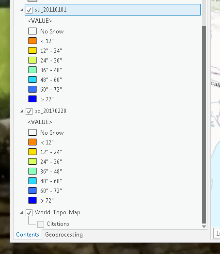

As a test to make sure the .lyrx file I was using was healthy, I added it to the Pro session through the Add Data button. This image shows it successfully added:

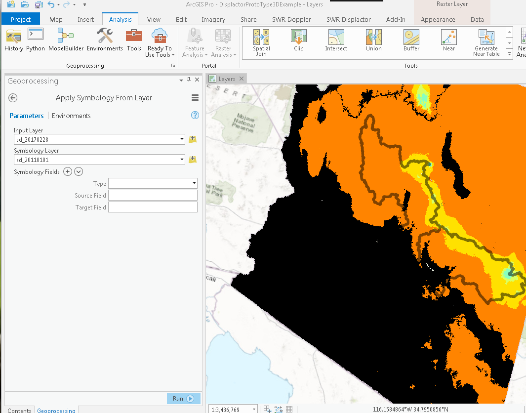

The following image shows running the Apply Symboloby From Layer tool using the just added GRID from the .lyrx file. When I populate the Symbology Layer input, the tool does not misbehave:
The final image shows the initial non-symbolized grid now with the proper symbology.
