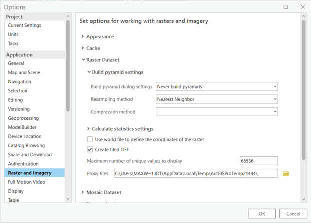

How can I use the SDK to control the items in the Raster and Imagery options, such as changing the Build Pyramid dialog settings?

I think Raster and Imagery options are not exposed to API.
Here you can find which options are exposed to API.

Thank you!! I did not find it in the API.
MaxW
I later switched to using the API to import Raster files, which prevents the dialog asking whether to build pyramids from appearing.
UmaHarano
FYI on this
Raster and Imagery Applications option (API Support) will available in ArcGIS Pro 3.4.
