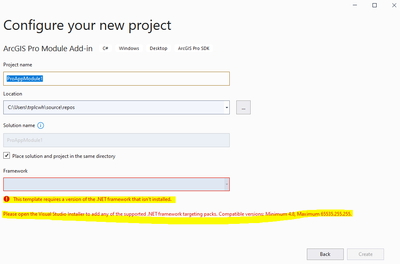

Does anyone know why I would be getting this message in VS when I complete the following steps:

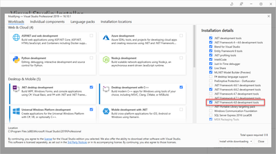

Run the Visual Studio Installer and click on Modify (I am running Professional .. hopefully that's the same on Community Edition).  Make sure to check under 'Installation Details' that the .NET Framework 4.8 checkbox is checked:
cwh
Yay, that was it! It was optional and unchecked.

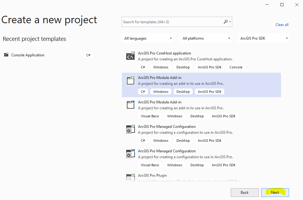

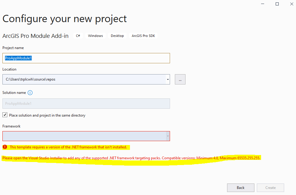

After doing the update on the installation and hitting the 'Create' button I get this message. I'm assuming that I've installed version 2.8 of the sdk while I have 2.7 of ArcGIS Pro. So I either need to upgrade to 2.8 version of Pro or uninstall sdk 2.8 and install an older version?
cwh
Just to wrap this up, it was to do with Pro version 2.7. Once I changed it to 2.8 this message disappreared.
