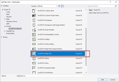

I am not sure what you mean, but the way to implement an interactive 'mouse click' on a map view is by implementing an 'ArcGIS Pro Map Tool' in your add-in by using the 'ArcGIS Pro Map Tool' item template:
Once you have implemented this and copied the relevant mouse click code from the community sample i mentioned above, you can use the map tool's button on the ArcGIS Pro ribbon tab.  If you want to use that same 'mouse click' tool from anywhere in your code or from a button on a dockpane you can use the Pro Guide for 're-using Pro Commands' to implement this functionality:  ProGuide Reusing Pro Commands · Esri/arcgis-pro-sdk Wiki (github.com)
