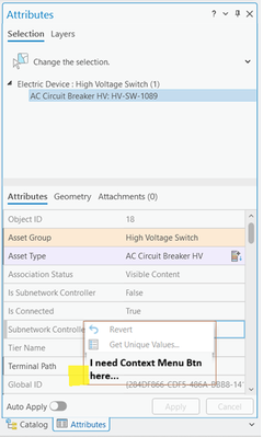

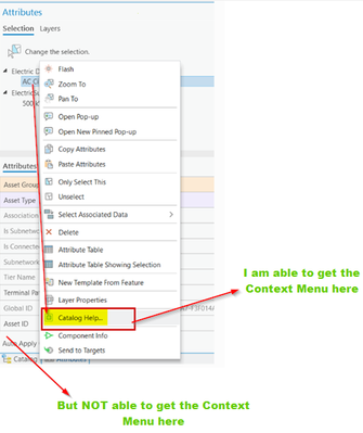

Problem Statement:
In the Attribute Pane, when right-clicking on actual field values or cells within the bottom grid, the expected context menu option “Catalog Help…” is not visible. However, I am able to add this context button in the Top section of the Attribute Pane as well as in the Attribute Table.
Below is the screenshot:

JMutunga
@RavindraSingh  Can you share a screenshot of the menu you are trying to add your button to?
RavindraSingh
@JMutunga  here is the screen shot of the menu I am trying to add. And on that button, I want to get the current layer  / table and that feature's objectid/globalid as well.
JMutunga
That menu is not currently exposed in the Editing daml.
Are you not able to do this on the esri_editing_Attributes_FeatureContextMenu? It would be great if you could provide more context why the menu on the grid is prefered.
RavindraSingh
@JMutungaI want to add a button that reacts to the specific field where the user has just right‑clicked. The goal is to detect which field was right‑clicked and then trigger an action based on that field. Different fields will have different actions associated with them.

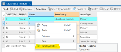

@JMutunga  Here is some more details how at Attribute Table context Menu it gives:
Context Menu Button Click Handler on Attribute Table:
Below source code implements a custom context menu button click handler. When a user right‑clicks within the Attribute Table of a Feature Class or Table, the handler retrieves the selected column name and the corresponding row’s ObjectID. The functionality is specifically designed to support a custom context menu button integrated into the Attribute Table interface.
