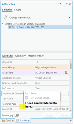

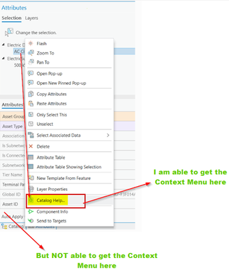

Problem Statement:
In the Attribute Pane, when right-clicking on actual field values or cells within the bottom grid, the expected context menu option “Catalog Help…” is not visible. However, I am able to add this context button in the Top section of the Attribute Pane as well as in the Attribute Table.

<updateMenu refID="esri_editing_Attributes_FeatureContextMenu">
	<insertButton refID="POC_Addins_CustomContext_Views_CatalogHelpBtn" separator="true" placeWith="esri_editing_Attributes_LayerPropertiesContextMenuItem" />
</updateMenu>
<!-- esri_editing_Attributes_FeatureRowContextMenu: Right-clicking a Map Feature (Point, Line, Poly) in the top selection tree. -->
<updateMenu refID="esri_editing_Attributes_FeatureRowContextMenu">
	<insertButton refID="POC_Addins_CustomContext_Views_CatalogHelpBtn" separator="true" />
</updateMenu>

here is the screen shot of the menu I am trying to add. And on that button, I want to get the current layer  / table and that feature's objectid/globalid as well.
The Reason Why I need this: I want to add a button that reacts to the specific field where the user has just right‑clicked. The goal is to detect which field was right‑clicked and then trigger an action based on that field. Different fields will have different actions associated with them.

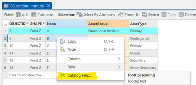

Here are some more details how at Attribute Table context Menu it gives:
Context Menu Button Click Handler on Attribute Table:
Below source code was implemented as a custom context menu button click handler. When a user right‑clicks within the Attribute Table of a Feature Class or Table, the handler retrieves the selected column name and the corresponding row’s ObjectID. The functionality is specifically designed to support a custom context menu button integrated but on the Attribute Table interface.
