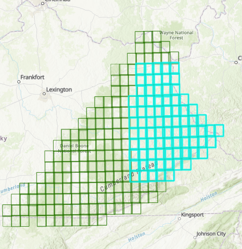

I generate a geometry from a current view extent and create a layer via LayerFactory. Then, I select features in the that intersects  with the created the geometry.
AGP zoom out all the way the layer extent and does not zoom back into the geometry extent. It happens only right after creating the layer. Afterwards, it works fine when layer does not need to be created again.

Amadeus111
interestingly it works when I create another QueuedTask and move ZoomTo in it
QueuedTask.Run(() =>{...});
   MapView.Active.ZoomTo(currentExtGeo);
