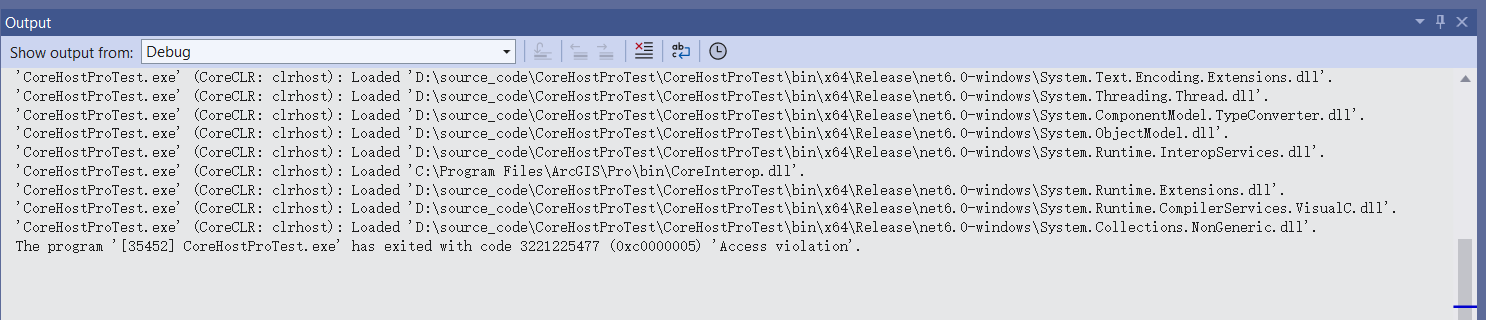

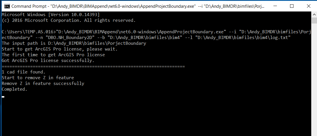

 The program will not exit normally like below screenshot:

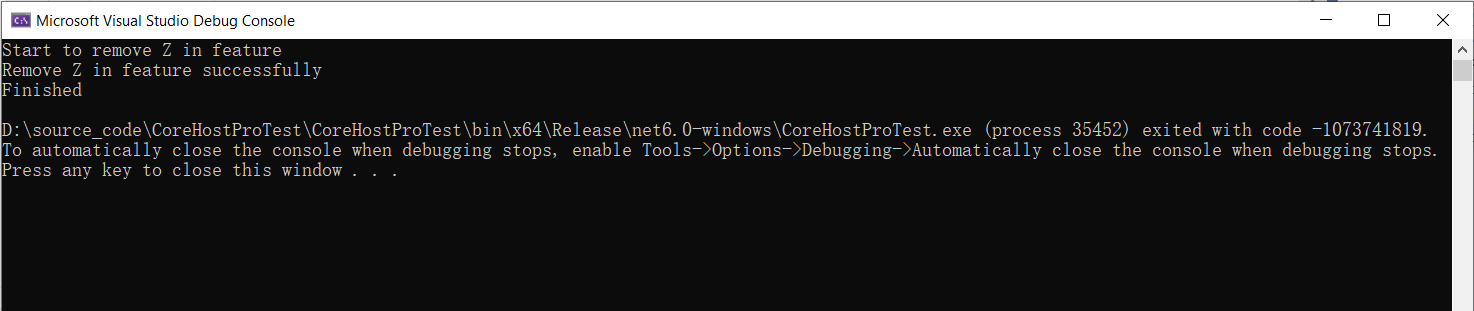

when debug in Visual studio 2022, it will display after finished:
And there is below error in output window of Visual Studio:

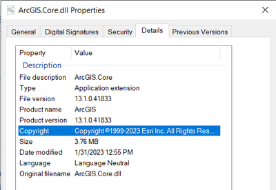

Could you tell me which Visual studio and SDK version you use?
My Visual studio 2022: 17.6.1
ArcGIS.CoreHost.dll: 13.1.0.41833
ArcGIS.Core.dll: 13.1.0.41833
gaofangwan_0-1694092980294.pnggaofangwan_0-1694092980294.pnggaofangwan_1-1694093002367.pnggaofangwan_1-1694093002367.png
GKmieliauskas
VS: Version 17.4.3
Check which ArcGIS Pro extensions for Visual Studio you use.
I use 3.1.0.48133
