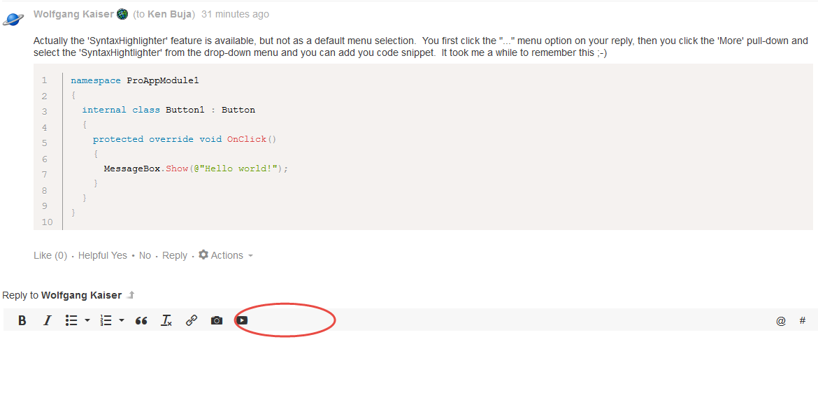

Wolf
by Esri Regular Contributor
Actually the 'SyntaxHighlighter' feature is available, but not as a default menu selection.  You first click the "..." menu option on your reply, then you click the 'More' pull-down and select the 'SyntaxHightlighter' from the drop-down menu and you can add you code snippet.  It took me a while to remember this 😉
namespace ProAppModule1
  internal class Button1 : Button
    protected override void OnClick()
      MessageBox.Show(@"Hello world!");
KenBuja
MVP Esteemed Contributor
The "three dot" menu item doesn't appear when you reply through the Inbox (shown here)
Wolf
I usually use the links I get through my notification emails: I get two 'inbox' links, and yes you are correct only one works as it provides the '...' menu option.
Wolf
I usually don't use that workflow path.  I reported the issue to the Geonet team.
