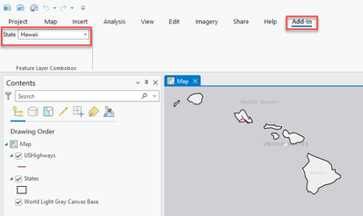

I attached a sample with a drop down list of features, however, the features are extracted from a feature layer  (specifically the States layer) not a feature class.  You can change the code by using @MatthewDriscoll  's snippet in order to get the drop down list data from a feature class.
I would also suggest that you get familiar with the Pro SDK you can find the Pro SDK landing page here:
ArcGIS Pro SDK | Documentation
As data for the attached sample i used the 'C:\Data\Admin\AdminSample.aprx' project & data which is distributed through the community samples release page (see link above).

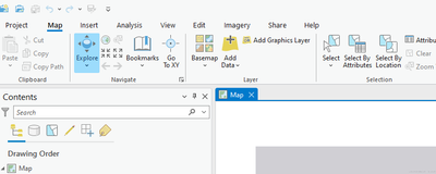

i cant get the sample to work, i can build it and it will put an add-in folder into the correct folder but when arcgis pro opens during debugging there is no add-in menu with the add-in ? (image below)  i can get other add-ins to work, (combobox sample) is there some reference missing?
AntEsk
i got it to work by moving the contents of the SelectFeature class contents to the class i had in my combox sample that works, so i guess there is a reference missing?

Sorry about that, i created this sample in my attachment above for the 3.2 community sample release.  To get it to work with ArcGIS Pro 3.0 or 3.1, you have to change the minimum desktop version of the add-in in the config.daml:
Change this line in config.daml:
<AddInInfo id="{b69d8233-0ca5-49ea-adc4-80ad26e2a8ed}" version="1.0" desktopVersion="3.2.48119">
To the following in order for the add-in to work with release 3.0 of ArcGIS Pro:
<AddInInfo id="{b69d8233-0ca5-49ea-adc4-80ad26e2a8ed}" version="1.0" desktopVersion="3.0.0">
