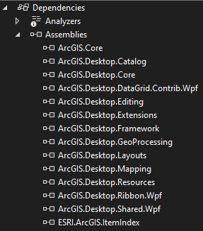

My old addin (coming from 2.9 and migrated into 3.0) needs some brushing up and I am getting some XDG errors from XAML file.
All the assemblies are where I would expect them to be: C:\Program Files\ArcGIS\Pro\bin or at C:\Program Files\ArcGIS\Pro\bin\Extensions\DesktopExtensions
I tried SDK utilities to fix Pro references, but it didn't help. I cleaned the solution, deleted the bin and obj directories of the solution.

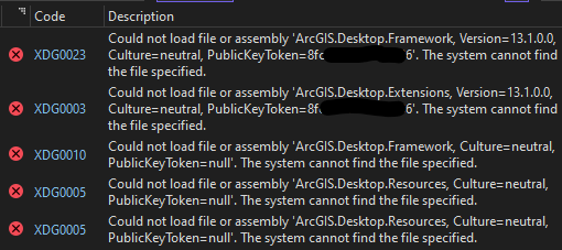

Here the error codes from above with the lines the error is encountered at
XDG0023d:DataContext="{d:DesignInstance Type=ui:PublicDataDockpaneViewModel}"
XDG0003<ResourceDictionary.MergedDictionaries>
<extensions:DesignOnlyResourceDictionary Source="pack://application:,,,/ArcGIS.Desktop.Framework;component\Themes\Default.xaml" />
</ResourceDictionary.MergedDictionaries>
XDG0010<ResourceDictionary.MergedDictionaries>
XDG0005<StackPanel Orientation="Horizontal">
<Image Source="pack://application:,,,/ArcGIS.Desktop.Resources;component/Images/GenericRun16.png" />
</StackPanel>
<Image Source="pack://application:,,,/ArcGIS.Desktop.Resources;component/images/genericreset16.png" />
</StackPanel>
Since the second error is pointing at an issue with the Default.xaml file I would assume the two XDG0005 are following errors resulting from the XDG0010.

Just a comment regarding Visual Studio 2022. The new version of VS treats many 'warning' messages as errors that stop a build. In VS these same issues were treated as warnings or informational only so you still could get a clean build. Check the error messages and see if you can change your build settings to ignore XDG0005 -them if they appear in consequential.

The errors you are seeing are coming from the XAML Designer in Visual Studio.  Unfortunately, Microsoft introduced a bug into the Designer where the Designer fails to locate required assemblies (this issue was introduced when we switched from x86/x64 mixed builds to x64 builds).  When you close the XAML Designer these errors are cleared.  These errors do not have any effect on the actual build.  Also Visual Studio and MSBuild seem to have no problem finding those assemblies.   I reported this issue to Microsoft but they claimed to have this issue fixed.
