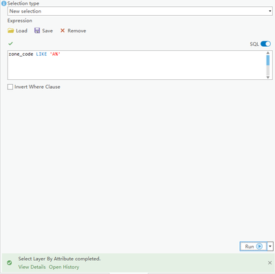

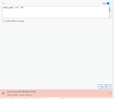

I need to find all featuress in the zone_code field that begin with N
I entered the sql as zone_code LIKE 'N%' Pro remind me with a wrong expression, this sql i can succeed with database query statement, but failed in pro.

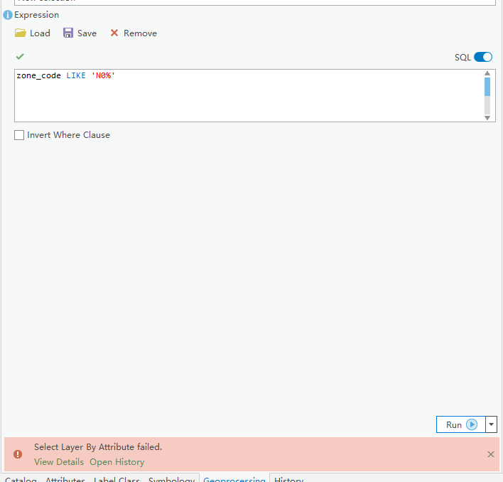

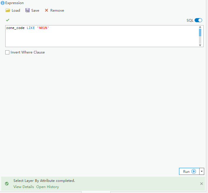

In addition, I entered zone_code LIKE 'N0%' also failed, only zone_code LIKE 'N01%' can be executed successfully. Why is that?

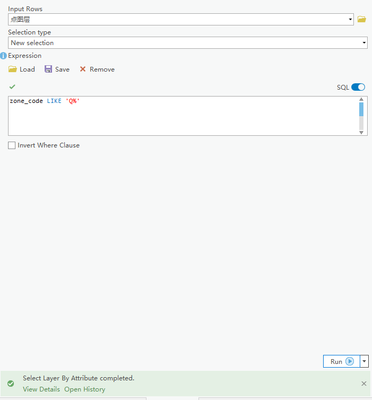

Chapin
Why is it that all other letters work but N% is invalid?
