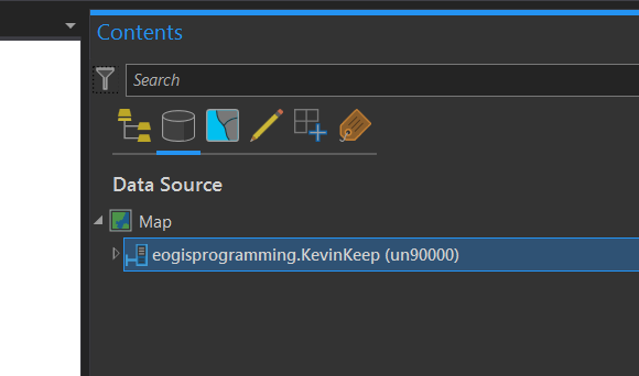

I have a Feature Service in my Map, no local sde files or file geodatabase (aside from default.gdb which I do not use).
I published this service with Version Management set to "true", from a Map with layers that reference a Branch - Versioned dataset.
Is the only way to retrieve the data source is by iteration through layer(s) using the ArcGIS Pro SDK?   I am trying to create a custom versioning tool and I wanted to place it in the same Tab as the other Versioning commands, and when that tab is active, no layers are selected in the TOC.  How do the existing commands (Post, Reconcile, Manage Versions etc) know the current selected data source?  I even tried subscribing to TOCSelectionChangedEvent, however the only arguments returned are MapViewEventArgs, which do not contain any context about selected Datasource in the TOC.

The tool that I am writing using the condition: esri_mapping_itemSelectedIsVersionableCondition to control the enabled status of my Add-in button.  This does not allow me to have a selected layer and selected datasource at the same time.
What I am asking for, is any way to get the list of data sources in the project.  If I want to get all the Layers in the Map, I would use MapView.Active.Layers.  Is there any sort of .GetDatasources() or GetSelectedDatasources() for the project that you have seen in the SDK?  I could not find anything and I do not want to have to rely on the layers being selected, or pulled from the Map.

I should have written my initial question better, it is a little misleading so I have corrected it.  In a nutshell, what I am asking is:
Is the only way to retrieve the datasource is by iteration through layer(s) using the ArcGIS Pro SDK?   I am trying to create a custom post/reconcile tool and I wanted to place it in the same Tab as the other Versioning commands, and when that tab is active, no layers are selected in the TOC.  How do the existing commands (Post, Reconcile, Manage Versions etc) know the current selected data source?  I even tried subscribing to TOCSelectionChangedEvent, however the only arguments returned are MapViewEventArgs, which do not contain any context about selected Datasource in the TOC.

After trying out Project.Current.EditedDatastores(),  it only returns ones with active edits for that client session.
Scenario 1: Draw a point, my datasource shows up in Project.Current.EditedDatastores
Scenario 2: Draw a point, save edits, Project.Current.EditedDatastores is empty.
esri_mapping_TOCSelectionValidForReconcile_condition is viable for button enabling/disabling.
