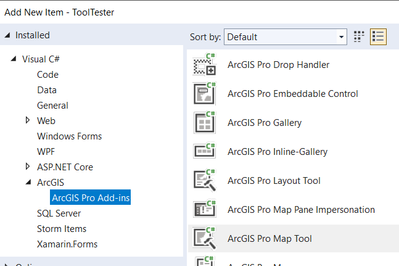

KirkKuykendall1
Something like this might work.
Right click on project and Add>New Item then choose Pro Map Tool.
In the daml, change the condition:
Change the OnSketchCompleteAsync override:

JohnHanson1
Mr. Kuykendall,
Perfect!  Thank you very much!  I had added some C# code to add layers from a selection, and it works like a charm.  I attached the modified code of the MapTool1.cs (zipped) below.
Once again, Thank you
John Hanson
KirkKuykendall1

JohnHanson1
Mr. Kuykendall,
John Hanson
