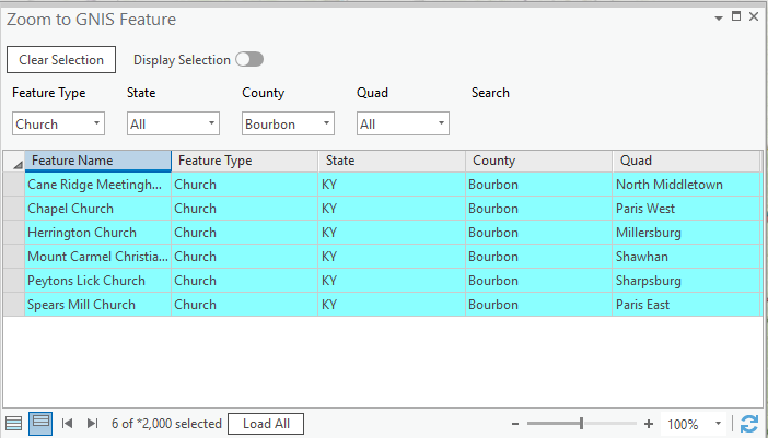

I have created a table view which users can filter features by making selection via multiple combo boxes

The method above works fine for selecting features based on multiple criteria taken from combo boxes.
I would also like to remove features from the display as user filters out the features.
