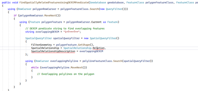

Have you looked into the options from  SpatialRelationship property of SpatialQueryFilter?
If the available preset options are insufficient, you should create a Relate string following Dimensionally Extended Nine-Intersection Model (DE 9IM) and pass it to the SpatialQueryFilter as in the snippet.

Any idea why I can't access Relation or SpatialRelationshipDescription ?
CharlesMacleod
fully qualify SpatialRelationship. Something in your code is conflicting with it

I have attempted that. I don't see it listed in the 3.0 documentation either.
https://pro.arcgis.com/en/pro-app/3.0/sdk/api-reference/topic6828.html
CharlesMacleod
yes, i agree, looks like that particular enum value is not part of the GDB at 3.0.
