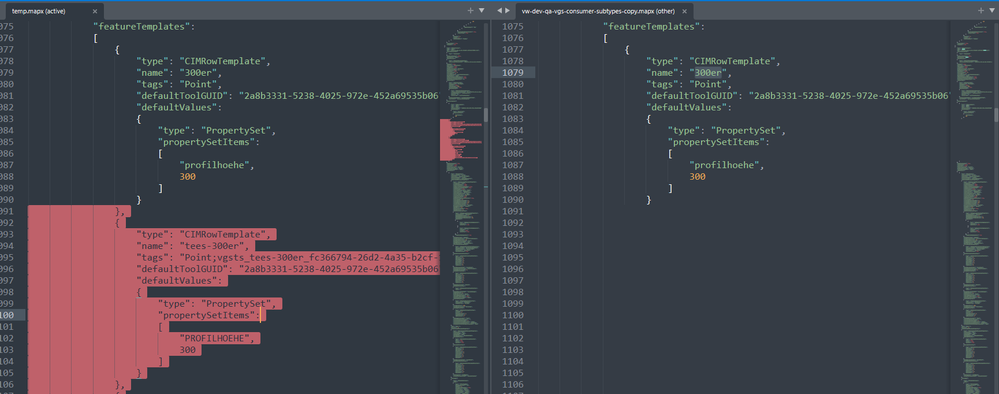

I got a custom script which does create some CIMRowTemplates and tries to insert these into a CIMMapDefinition more specifically into a SubTypeLayer. Unfortunately the self generated CIMRowTemplate always seems to dissapear as soon as I import the .mapx file into ArcGIS Pro.
On the left side is the manipulated .mapx file and the self generated CIMRowTemplate 'tees-300er' (marked red). It seems almost identical to the default Feature Template '300er' directly above
On the right side you see the .mapx File after I imported it into ArcGIS Pro. The self created CIMRowTemplate just vanished.
I have absolutely no problem when creating CIM templates and importing them into 'regular' layers (non subtype layers).
The CIMRowTemplate JSON just looks fine, so I got the gut feeling that there is something not right behind the scenes. I got absolutely no clue why my template does not seem to be 'valid'?

I just figured it out myself! I had to set the 'autoGenerateFeatureTemplates' property to False before applying the cim definition to the layer. Then it worked. Just a bit confusing that I dont have to do this for 'regular' layers and only for sub type layers.
layer_definition.autoGenerateFeatureTemplates = False
