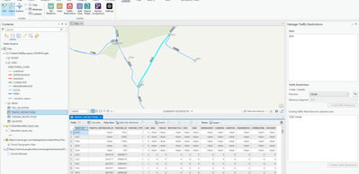

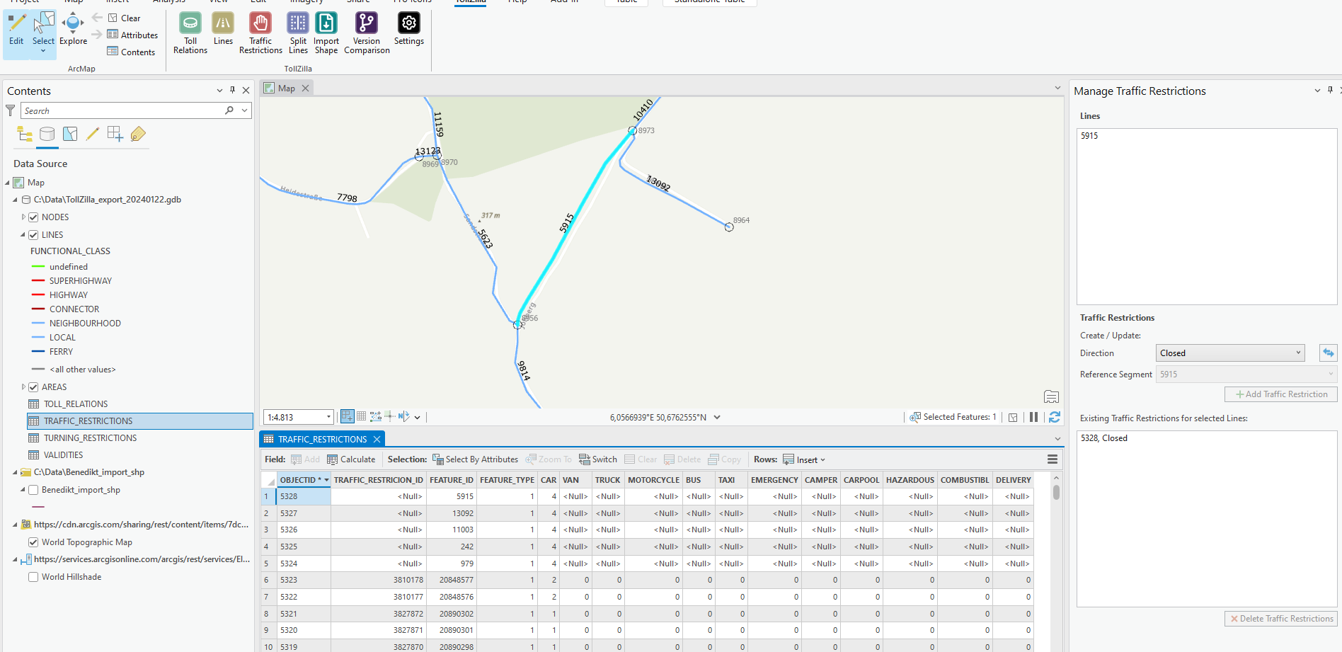

Therefore I am using editsession.Create(featurelayer or table) to insert. But only in case of featurelayer I do see new entries within the tableview grid. Adding new rows in the standalone tables are not showing up within ARCGIS Pro build in "Attribute Table". It is even not enough to close the current edit session and store the changes. I do have to reopen the project to see my changes. Another try was to use "MapMembers" instead of Table for the standalone table. But this didn't change anything.
 I do not have this problem when I use a local gdb instead of the remote oracle db (like in my screenshot).
