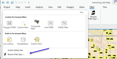

Hi Everyone!
I implemented the inline gallery template item and got that working. However, I noticed that the inline gallery seen on the Analysis tab for Geoprocessing tools has a niffty 'Customize' utility, and 'Tools' lookup menu item at the bottom that does not appear with the SDK inline gallery item template.  Anyone know if this is possible to implement? Not seeing anything that leaps out in the SDK documentation.
