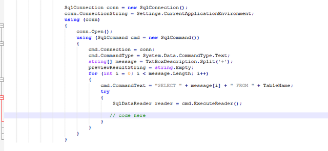

I'm using LabelBuilder to assign labels to the events posted on the line feature class, and there's a button for verifying the label. So, for the SDE database, I implemented it using the code below, but I'm not sure how we can do it in FGDB.
