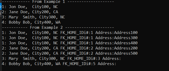

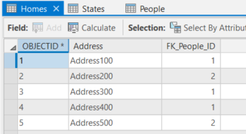

Hi @DHuantes, I am not able to reproduce the syntax error from the provided sample. Did you see any specific error message when this happened?
In order to investigate the error, I have created 3 tables with dummy data and run QueryDef as on example1 and example 2 and both of them gave me the results  -
Example: 1
Example: 2
Output:
DHuantes
