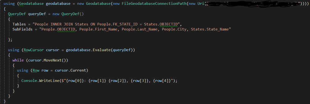

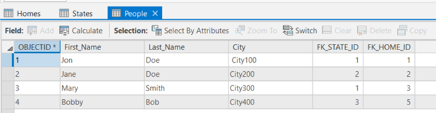

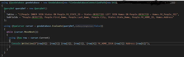

Hi @DHuantes, I am not able to reproduce the syntax error from the provided sample. Did you see any specific error message when this happened?
In order to investigate the error, I have created 3 tables with dummy data and run QueryDef as on example1 and example 2 and both of them gave me the results  -
  AashisLamsal1_0-1606160189766.pngAashisLamsal1_0-1606160189766.pngAashisLamsal1_1-1606160200063.pngAashisLamsal1_1-1606160200063.png
Example: 1
Example: 2
Output:

KimberlySaballett
I was able to reproduce your error with the above solution and fix it by removing the parentheses in the SQL expression. SQL is executed from left to right so the parentheses here were unnecessary.

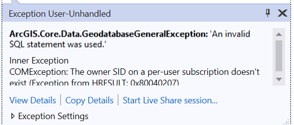

PARTHASARATHIU
@ChristopherKoenig @KimberlySaballett @Aashis QueryDef mainQueryDef = new QueryDef
Tables = $"DD_PLAN_1_STUDENT_COUNT LEFT JOIN ({"SELECT DD_PLAN_1_STA_ENROLLMENT.SCHL_ATND AS SCHOOL, Sum( DD_PLAN_1_STA_ENROLLMENT.TOTAL_ENROLLMENT) AS TOTALENROLL, SUM(DD_PLAN_1_STA_ENROLLMENT.GPK+DD_PLAN_1_STA_ENROLLMENT.GK+DD_PLAN_1_STA_ENROLLMENT.G1+" +
"DD_PLAN_1_STA_ENROLLMENT.G2+DD_PLAN_1_STA_ENROLLMENT.G3+DD_PLAN_1_STA_ENROLLMENT.G4+DD_PLAN_1_STA_ENROLLMENT.G5+DD_PLAN_1_STA_ENROLLMENT.G6) AS [PK-6], SUM(DD_PLAN_1_STA_ENROLLMENT.GPK) AS GPK, SUM(DD_PLAN_1_STA_ENROLLMENT.GK) AS GK, SUM(DD_PLAN_1_STA_ENROLLMENT.G1) AS G1, SUM(DD_PLAN_1_STA_ENROLLMENT.G2) AS G2, " +
"SUM(DD_PLAN_1_STA_ENROLLMENT.G3) AS G3, SUM(DD_PLAN_1_STA_ENROLLMENT.G4) AS G4, SUM(DD_PLAN_1_STA_ENROLLMENT.G5) AS G5, SUM(DD_PLAN_1_STA_ENROLLMENT.G6) AS G6, SUM(DD_PLAN_1_STA_ENROLLMENT.G7) AS G7, SUM(DD_PLAN_1_STA_ENROLLMENT.G8) AS G8," +
" SUM(DD_PLAN_1_STA_ENROLLMENT.G9) AS G9, SUM(DD_PLAN_1_STA_ENROLLMENT.G10) AS G10, SUM(DD_PLAN_1_STA_ENROLLMENT.G11) AS G11, SUM(DD_PLAN_1_STA_ENROLLMENT.G12) AS G12 FROM DD_PLAN_1_STA_ENROLLMENT GROUP BY DD_PLAN_1_STA_ENROLLMENT.SCHL_ATND"}) AS DD_ENROLLMENT ON DD_PLAN_1_STUDENT_COUNT.SCHL_NAME = DD_ENROLLMENT.SCHOOL",
SubFields = "DD_PLAN_1_STUDENT_COUNT.SCHL_NAME AS SCHOOL, " +
"DD_PLAN_1_STUDENT_COUNT.GRD_RANGE AS GRADES_SERVED, " +
"DD_ENROLLMENT.TOTALENROLL + DD_PLAN_1_STUDENT_COUNT.TOTAL AS ENROLLMENT, " +
"DD_PLAN_1_STUDENT_COUNT.[RS], " +
"DD_PLAN_1_STUDENT_COUNT.[OD_UM], " +
"DD_ENROLLMENT.PK6, " +
"DD_ENROLLMENT.GPK, DD_ENROLLMENT.GK, " +
"DD_ENROLLMENT.G1, DD_ENROLLMENT.G2, " +
"DD_ENROLLMENT.G3, DD_ENROLLMENT.G4, DD_ENROLLMENT.G5, " +
"DD_ENROLLMENT.G6, DD_ENROLLMENT.G7, " +
"DD_ENROLLMENT.G8, DD_ENROLLMENT.G9, " +
"DD_ENROLLMENT.G10, DD_ENROLLMENT.G11, DD_ENROLLMENT.G12",
WhereClause = schoolClause
It throws errors: invalid SQL statement. How can I resolve this issue using ArcGIS Pro add-ins in WPF?
