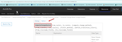

UmaHarano
Hi,
Try using the tool name mentioned in the Python tab on the tool documentation.
Muhammad_Elbagoury
Thank you for your support:
This worked "Geoprocessing.OpenToolDialog("ComputeChangeRaster", null);"
