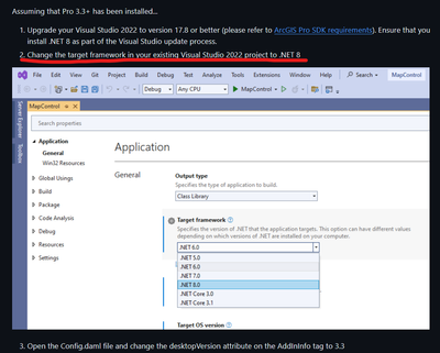

ArcGIS Pro moved to .NET 8 at release 3.3. so update the target framework to .NET 8 and VS 2022 (17.8 or higher).
More details - https://github.com/Esri/arcgis-pro-sdk/wiki/ProGuide-NET-8-Upgrade

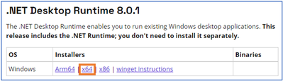

Place to start is to ensure your Visual Studio 2022 is at version 17.8 or higher and that you have .Net 8 installed.

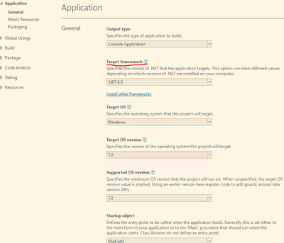

Esri kinda sorta breezed over the instructions in Step 2 to change the Target Framework. For anyone else who struggled to find/load the Target framework screen in Step 2, go to your project's Solution Explorer and click the "Properties" wrench. That will populate the Application settings tab where you can change the Target framework.
