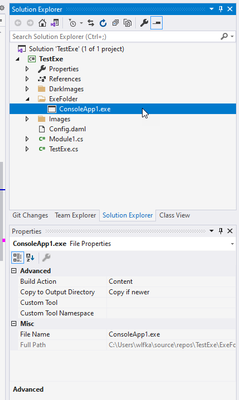

I attached a sample project that runs a console app.   This how you set the properties for the exe that has to be included in your esriaddinx file:
The project is for ArcGIS Pro 2.8, but you can change that in the config.daml to an earlier version:
LakshmiAlaparthi
Thank you! I was able to deploy the exe and and the .config file!
