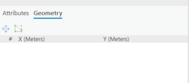

Hi,

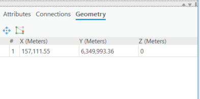

On selecting the plugin data sources features, data in the geometry tab in the attributes pane is missing. Usually, when we select features, geometry tab in the attributes pane contains information related to X, Y and Z coordinates.
But for plugin data features, geometry tab is empty.
Besides running my own code, I ran code from the Pro's community samples but result is still the same.

Hello,
Thanks for finding and highlighting this problem with the missing data on the Geometry tab with plug in datasources. I am able to duplicate the same behavior. Unfortunately there is no work-around to be able to display the coordinate data.
I have logged an issue for this to be fixed in the next software release.
