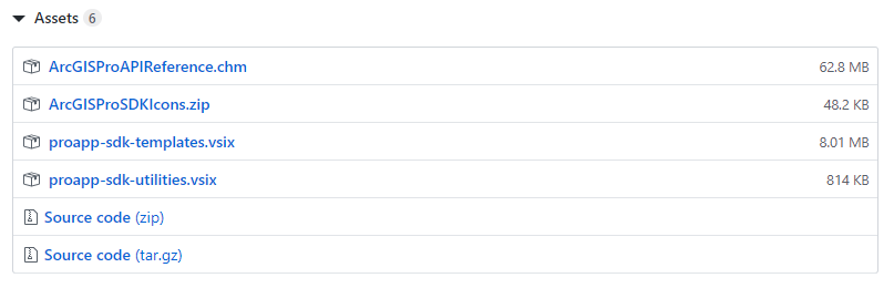

The Visual Studio Marketplace only provides the latest version of the Pro SDK.  For earlier versions, go to this section and choose the SDK version you want.  Click on the 2.1 link and you'll be taken to the page for that release.  Be sure to note all the requirements, etc.  Scroll down to the bottom to find the Assets download section.  Here you can download the VSIX files for installing with Visual Studio.
