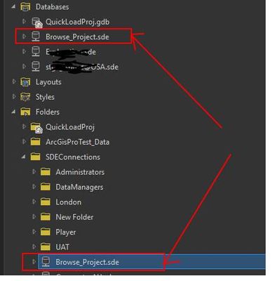

Refer to below example screenshot. for BrowseProject.sde item, user can choose from Databases or Folders. I have a specific analysis requirement whether user more frequently use this sde connection from Database container or Folders container.
So after user select the item, I need to find out, which container is the origin.

Refer to my image: The first project item , it's parent container is databases, and second project item, it's parent container is folder connection (folders). in the catalog pane.
First item parent object should be like
 Project.Current.GetProjectItemContainer("GDB");
Second item parent object should be like
Project.Current.GetProjectItemContainer("FolderConnection");
Currently I can't figure out from selected project item (selected item), something like which property to use.
