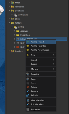

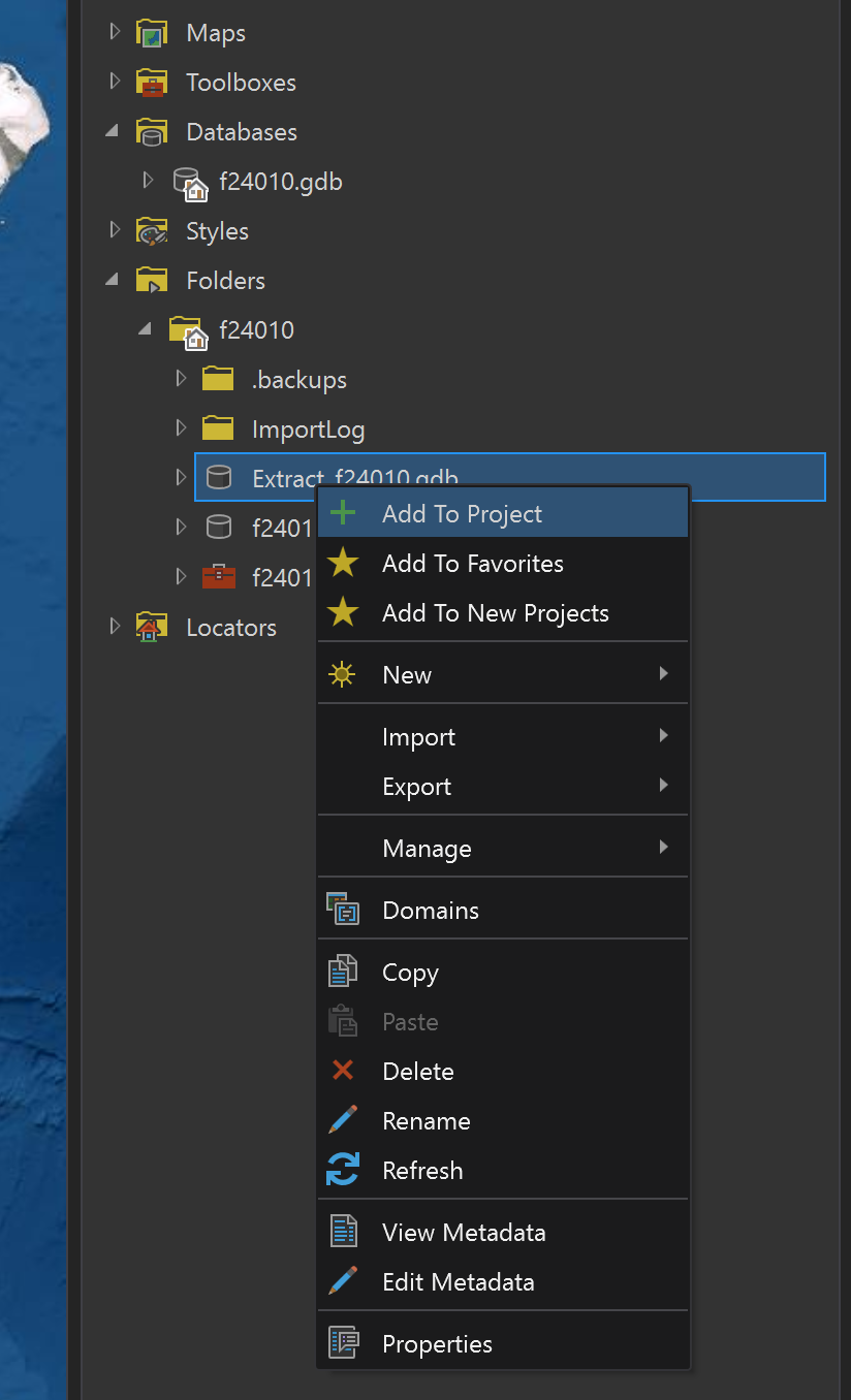

Hello dear community,
I've created a small program that does create a series of projects and that also creates individual FGDBs inside those projects.
For example, I have a project named f24010 and within that project there is a FGDB named Extract_f24010.
I can see the FGDB in the folder "Folders", but I can't see the same database in the folder "Databases"
Using ArcGIS Pro SDK, how can I add a reference to the FGDB in the "Databases" folder?
Mario
