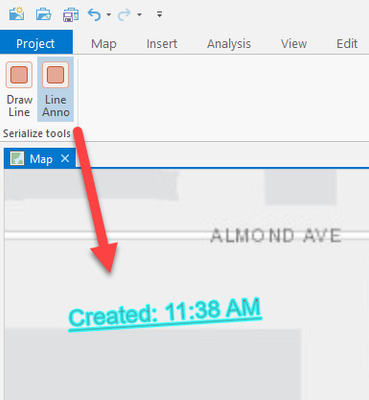

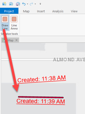

Neither ArcGIS Pro nor the Pro SDK support activating two tools at the same time.  If you write your own tools you can 're-use' a tool from OnSketchComplete of another tool.  I attached a sample project to demonstrate this pattern.  The attached add-in contains two tools: the 'Line Anno' tool which allows to draw a line and places an annotation feature and the 'Draw line' tool that creates line feature and then uses the 'Line Anno' tool code to create the annotation feature attached to the line.
When i use the 'Line Anno' tool the add-in places an annotation feature:
then I use the 'Draw Line' tool to draw a line, which is used to create a new line feature, but once the line feature has been created the code of the 'Line Anno' is called with the same geometry:
I attached the SampleAnno.ppkx to test the add-in and all source code.
