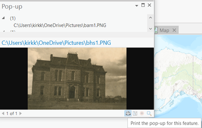

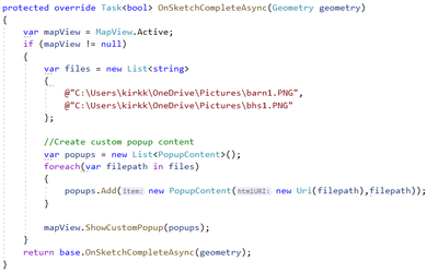

This works on my machine with 2.9 and my default printer configured for Microsoft print to pdf.
KirkKuykendall1
RogerAsbury
Checked my version and I was still back at 2.8.2. Updated to 2.9 and it started working as expected. Guess I need to pay more attention to when updated are issued. Thanks much!
