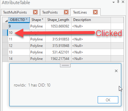

I will make the developer of this control aware of this issue.  However, there is a solution to get the selected row for a TableControl by using the ActiveRowIndex attribute of the TableControl.  In order to illustrate this i update this sample: Map-Exploration - TableControlsDockpane sample
I updated the XAML in Map-Exploration\TableControlsDockpane\AttributeTable.xaml by adding the ActiveRowIndex attribute to my TableControl:

 The trick is to add "Mode=TwoWay" to the ActiveRowIndex attribute in XAML and that ActiveRowIndex is also set when the row is unselected.  Running the code is get this:
