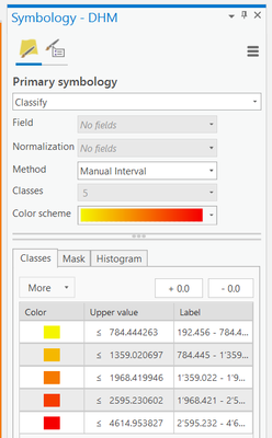

I want to create a class breaks renderer (with manual intervals) for a raster layer:
I have found a sample here: https://github.com/Esri/arcgis-pro-sdk-community-samples/blob/master/Map-Authoring/Renderer/ClassBre... (internal static Task CBGraduatedColorsManualBreaks()).
This is exactly what I want, but for a feature layer. How can I achieve this for a raster layer? I haven't found anything.
Thank you for your help in advance!
