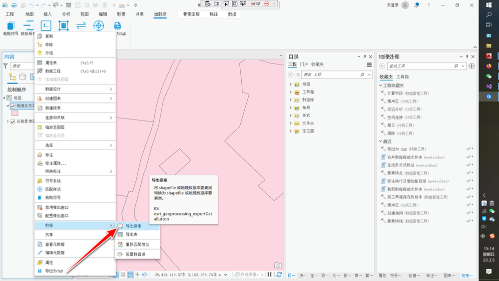

I want to add a  button to the data group in the right-click menu, but I can't find the place to add it in DAML.
Can someone tell me where this seat is, please?

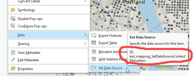

This is how I find the menu/group/tab etc I want in the DAML:

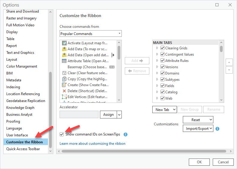

Step 1: Turn "show command ids on screen tips" on in the backstage options.
Step 2: Hover over an item already on the menu/group/etc u want. Pay attention to the DAML ID.

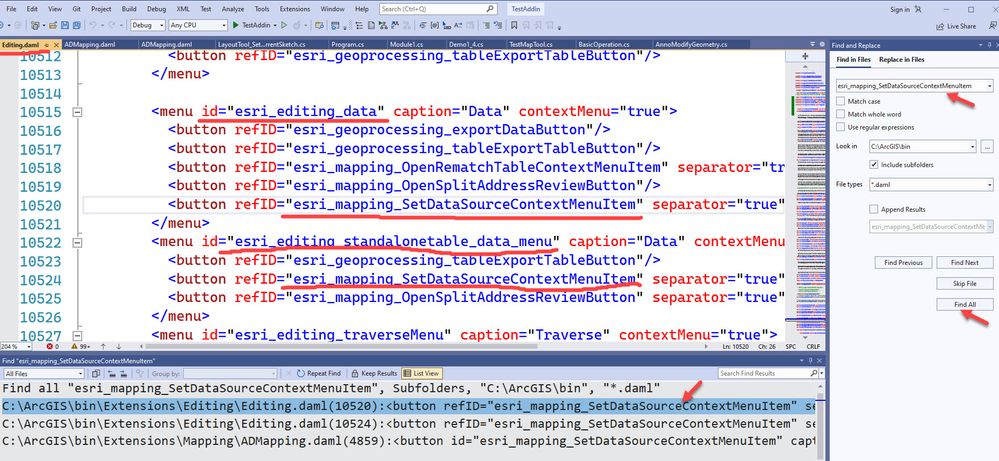

Step 3: Search for the DAML ID (from step 2) in the Pro install folder in the Pro *.daml files
Step 4: Look for all refIDs - that is where it is used in the application. In this case, there are two: "esri_editing_data" for layers and "esri_editing_standalonetable_data_menu" for standalone tables. You want "esri_editing_data" for layers".

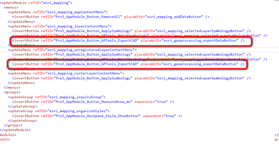

圈圈
I tried to add in this location, but was unsuccessful.

Thank you very much. Your answer has solved my question perfectly.
