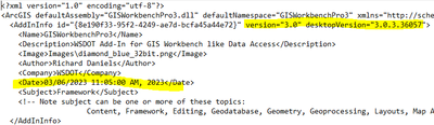

Two things to check.
1. in your Config.daml did you update the DATE prior to your (re)build? ArcGIS Pro will only reload an Add-in into the cache if the date has been changed in this file.
2. delete all files from your solutions folder in the.\bin directory. This is where your build results are saved; if you click into the folders, you should see a Debug, Release folder then a net6.0-windows folder that contains the actual compiled Add-in.

No, if you update the Config.daml date and have edited at least one form or module it should work. However, if it does not then you need to do a Clean Solution | Rebuild Solution to pick-up your changes.
Visual Studio 2019 was better than 2022 in doing complete builds. VS 2022 try's to be Smart and will not rebuild a file if it thinks the Resources have not changed. Unfortunately, for an ArcGIS Pro Add-In this does not result in the desired behavior.
