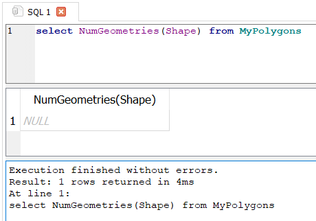

Hi -
I was pleased to find "C:\Program Files\ArcGIS\Pro\bin\spatialite400x.dll".  (I wasn't expecting it since there's no mention of spatialite in Esri's 3rd Party Acknowledgements doc.)
I'm able to load it as an extension in Db Browser; however, the spatialite polygon queries all seem to return null.
Am I doing something wrong?
Thanks, Kirk

RichRuh
Hi Kirk,
We have this working in-house, so it might be something with your environment or your database file.  You might want to open a tech support issue so that we can take a closer look.
(SpatialLite should be in the 3rd Party Acknowledgement doc)
--Rich

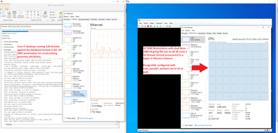

The Pairwise Dissolve tool is actually just running on a modest 4C/8T Core i7 desktop (32GB RAM though). And I only set the geoprocessing environment to allow 75% 3C/6T usage of the processor, so as to not completely consume this limited CPU.
The database is running on a HP Z840 workstation though, a refurbished one that I recently acquired, and has dual Xeon E5-2680 v4 with 14C/28T each, so 28C/56T total.
This is some custom Python multi-threaded code I developed (unrelated to the SQLite stuff), that goes flat out at 100% usage on the database server generalizing geometries in PostGIS:
