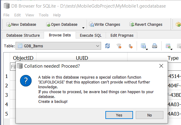

Using Arc Pro 2.7, I created a mobile geodatabase, then opened it with DB Browser for Sqlite 3.12.1.
When I chose to browse the GDB_Items table I get this warning:
Is this something I should worry about?
Thanks, Kirk

Hi Kirk,
 I reached out to the GeoDatabase team and it turns out that GDB_Items has a spatial column that requires the ST_Geometry extension to be loaded.  I think you already mentioned that you downloaded the ST_geometry extension DLL from MyEsri, I haven't verified this yet, but the ST_Geometry library is named stgeometry_sqlite.dll (or, on Linux, libstgeometry_sqlite.so).
 You need to use "Tools | Load Extension ..." to load the extension in 'DB Browser'.
The GeoDatabase team also mentioned that they are working on documentation describing the use of mobile geodatabases with 3rd party software pacakages and the ST_geometry.dll as part of the 2.8 release.

KirkKuykendall1
The Load Extensions button is grayed until I open a geodatabase.
After opening a geodatabase readonly, I click Tools>Load Extension in Db Browser and choose the dll. I then get the same warning pop up.  But then I don't get the warning when opening GDB_Items.
Since I'm opening the DB Browser readonly, I bet it's a bug in DB Browser.  If it's readonly I don't see how anything bad could happen.
